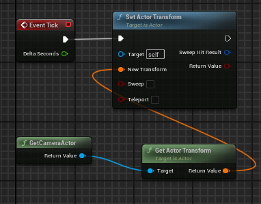

i want to apply the position and rotation data of the ZED pawn to the Cine Camera Actor
The ZedPawn actor already contains a Cine camera, do you want to move another camera in the scene?
You should be able to get the transform of the ZED Pawn and apply it to your camera easily with a small blueprint.

Create a blueprint actor, add a cine camera to it.
And in the event graph,add something like that :
