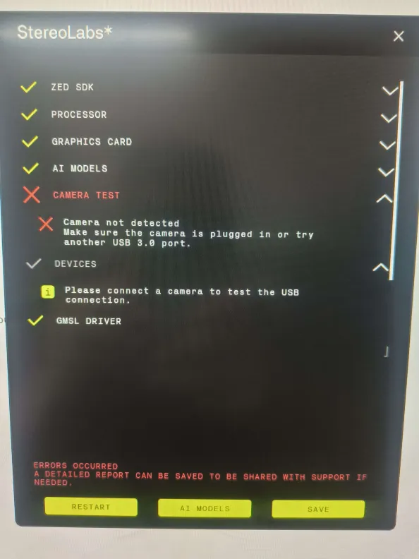

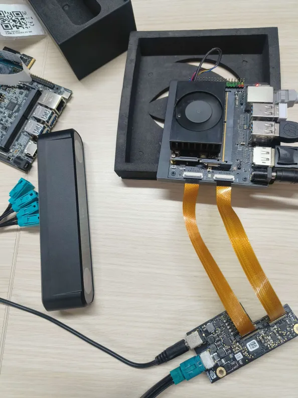

I’m using a Jetson Orin NX with the ZED X camera connected via the ZED Duo Capture Card. The system is powered by a stable 14–19V power supply. The software stack is based on JetPack 5.1.2, and all necessary drivers, including the GMSL driver, are correctly installed and detected by the ZED_Diagnostic tool. All hardware connections between the Jetson and the capture card have been verified and confirmed to be functional. However, the camera is not being detected, and the LED on the ZED X has never turned on since the setup was completed two weeks ago. Additionally, the capture card is drawing only around 0.004A, indicating that it may not be supplying adequate power to the camera. Despite having all hardware and software requirements in place, the camera fails to initialize, suggesting a possible issue with the capture card, power delivery, or the camera hardware itself. I’ve also tried with 2 different boards in any of the case the LED didnt blink

I tried with both Waveshare and Seedstudio j4012
These carrier boards are not officially supported. Therefore, we cannot ensure that our capture card and driver will function with them, as we do not conduct validation tests on these boards.

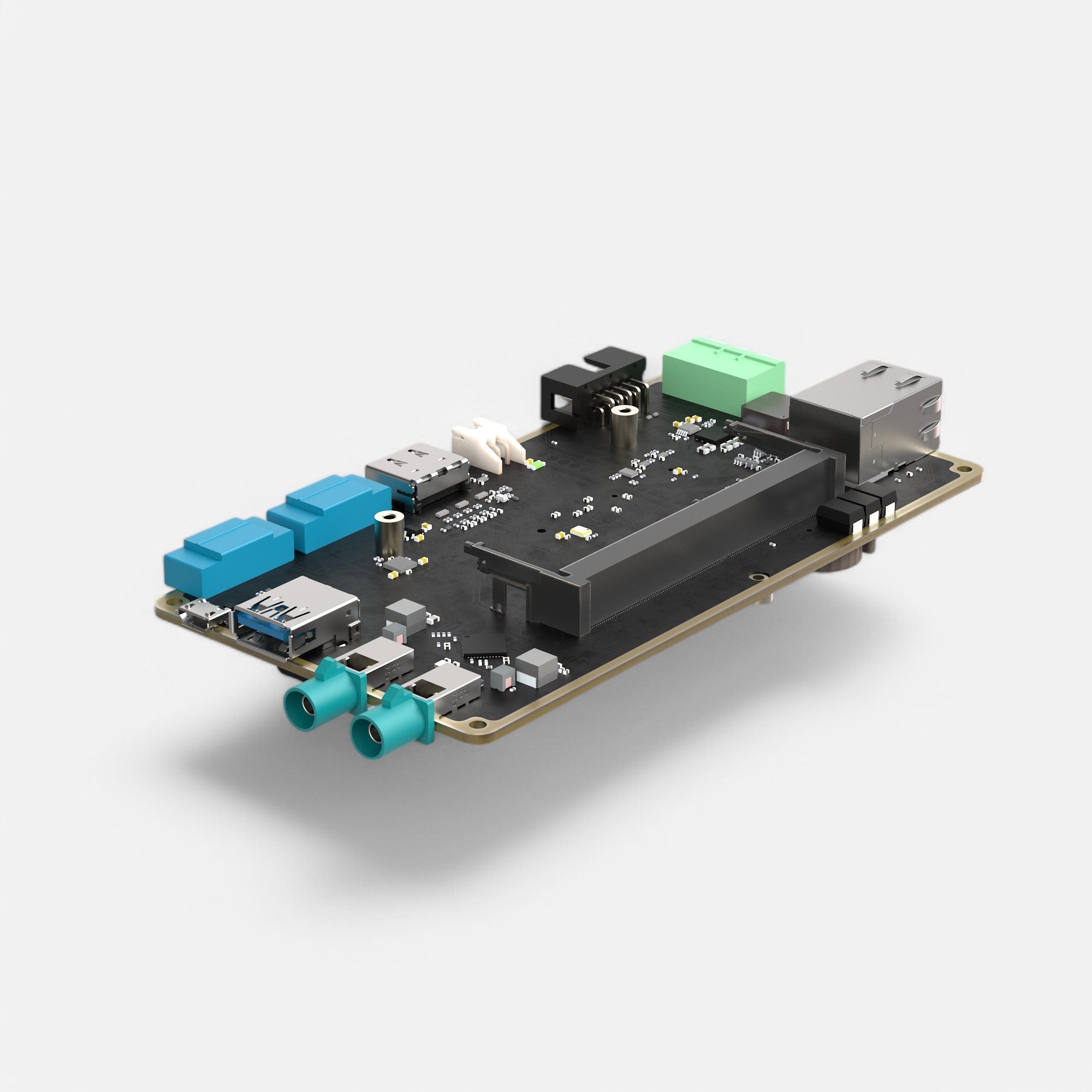

You can consider our carrier board, which is compatible with Orin NX:
