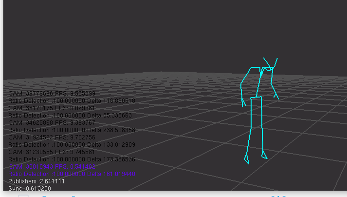

I am getting 8-9 FPS now. Here is what I am running (SDK 4.0.7, Edge body tracking 0.8.1, newest edge_cli):
HUB:
- Edge Body Tracking App
- Accurate detection model
- Body 18 (No out-of-the-box option for body 34)
- Body tracking and body fitting DISABLED
- HD1080, Ultra depth, 30 fps
Application:
- Multi-camera application from your ZED SDK samples (C++)
- Body 34
- Body tracking and body fitting ENABLED (both in sender and receiver - I need to get positions of all joints at all time steps, and I need ID of detected people).
- allow_reduced_precision_inference set to TRUE
How can I increase FPS while still making sure all joint positions are estimated at all timesteps? I find it strange that I have to have the Edge body tracking app enabled to run my sample - why is that? Can I optimize the app to not send its stream to the hub if that helps?
You should definitely disable the fitting. The fusion will not take it in account anyway, and will re-fit the persons afterwards.
@alassagne Disable it in the ClientPublisher (BodyTrackingParameters), or in BodyTrackingFusionParameters or both?
In the client publisher. They key is to increase the framerate of the sender. The receiver is less important because it has a lot less work to do. Also, in your case if you use Body 34 you need the fitting, but on receiver side.
I am getting 8-9 fps running with body tracking and fitting disabled in client, enabled in receiver (body 34). How can I get it higher?
Are the recordings enabled ? That can save some framerate. Also what about the MEDIUM model ?
All recordings are off. I get 10-12 FPS running the medium model, and the detection is a bit smoother (less strange glitches where body parts are stretched a lot).

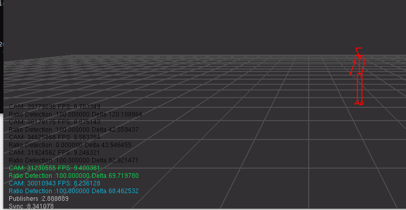

With the following settings in the hub I now get 12-13 FPS:
- allow_reduced_precision_inference = true
- Body 34
With the same settings but medium detection model I get 14-15 FPS.
Q: With my given FPS results, would you recommend accurate or medium model for most precise and non-glitchy skeleton detection? Also, what do you recommend during calibration?
Q2: Given that the hub application does control the cameras, can it be optimized to run faster? Any suggestions?

The client publisher is only here for USB cameras. The multicamera sample can use network zed (with or without hub) but you’ll have to fill the values in the configuration file, and run an app on the sender side.
