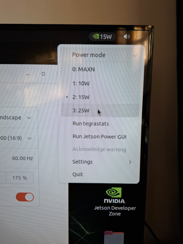

Please add more information about this point. What were you using before?
The default setting of 15W, see attached photo.
This normally affects only the runtime performance; I do not believe this can change anything when you reboot the Jetson Module in Force Recovery Mode…
