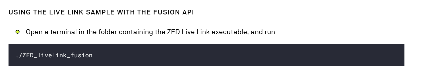

I would like to test your Live Link Sample with the fusion API as you mention here
but i cant find the executable in your git hub repository containing the plug in and also l cant find an example of live link sender in the repository containing the SDK.
Could you point me to where the sample file is or to an example streaming multiple cameras over fusion (body tracking)?
Thanks in advance
There is no built executable available in the github repo (GitHub - stereolabs/zed-livelink: ZED LiveLink Plugin for Unreal), you have to built it yourself following this guide (Building a C++ Application on Windows - Stereolabs)
Thank you, got it. It works now.
