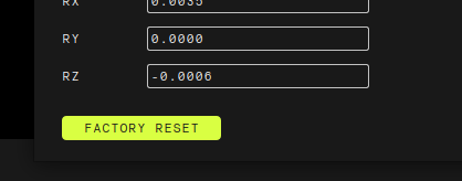

Why have you recalibrated the camera? All the ZED cameras leave our factories precisely calibrated in a calibration cage with robotics arms.
Manual calibration must be performed only if you are using the cameras in specific conditions (ie underwater, behind a curved glass, …) or if they received physical or thermal shocks that could have modified the configuration of the lenses.
Is recommend you open ZED Explorer and you click the FACTORY RESET BUTTON in the Calibration Window:
