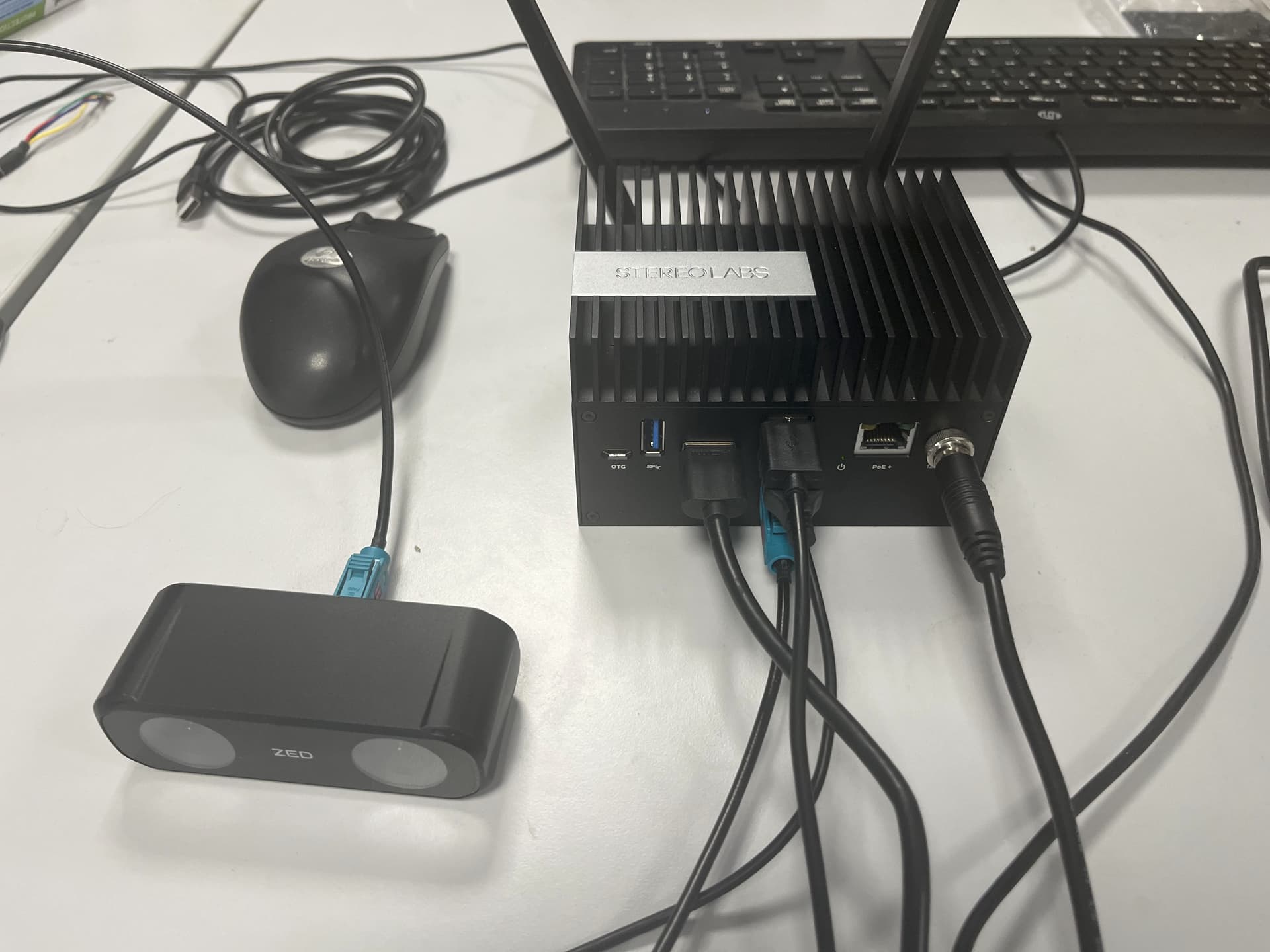

Hello, I’m currently having a problem with my ZED X Mini camera not being detected by a ZED Box Orin NX 8GB.
Any help in locating and solving this problem is most welcome.
Diagnostic results
At the bottom of the post, you’ll find the diagnosis generated by the ZED_Diagnostic tool.
Actions already tried (without success)
- I reassigned the rights to the ZED Box user, as indicated in a post I had followed to solve a similar problem in the past.
- I tried to reinstall ZED-Drivers using the latest version available, but it returned the following error:
dpkg: error processing archive ./stereolabs-zedbox-onx8_1.2.1-SL-MAX9296-ALL-ZEDBOX-L4T35.3.1_arm64.deb (–install):
trying to overwrite ‘/boot/stereolabs/tegra194-p2822-0000.dtb’, which is also in package stereolabs-zedx 1.0.2-SL-MAX9296-L4T35.3.1
dpkg-deb: error: paste subprocess was killed by signal (Broken pipe)
Complementary information
- The ZED Box Orin and the ZED camera are connected with a GMSL2 Fakra F-F cable. I only have this cable, which prevents me from testing another or connecting the camera to another device.
- In a previous context, the Orin ZED Box was connected to the camera, and everything worked perfectly. Since then, the camera and ZED Box have been moved, involving disconnection and reconnection.
- To the best of my knowledge, the ZED Box, the cable and the camera have not been damaged. However, it is possible that the camera has been subjected to vibration (without any impact).
