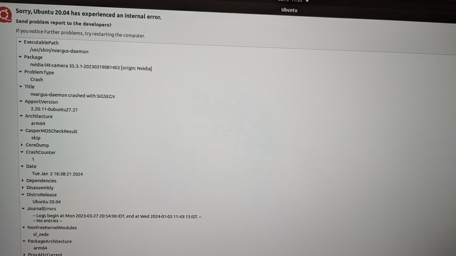

Could this be a timeout failure from the camera either due to it not sending frames back to the computer or some other miss synchronization resulting in the nvargus-daemon crashing (see picture bellow ) ?
How do you recommend in resolving this ? Is upgrading the jetpack version relevant (in this version they state that theres “Enhanced error resiliency for improved stability in Argus”) when using the zed box and zed x camera (it was rested to version 5.1.1) ? Or is the source of the error to be found with the camera ?

Do you happen to observe the argus errors while using a sample without recording? Upgrading Jetpack can be a good idea to reduce these types of errors, but this should be unrelated to recording.
We will test this configuration on our end to see if we can reproduce your errors.

I’ll check the SVO file recovery command as you suggested on Sunday (I’m out of office until then). However, I’m more concerned about the zed box and the camera not being able to handle the data stream and recording properly without any additional real time logics we are planning to add. What do you think is the source of this problem? The machine is supposed to handle 4 cameras running yet we are getting timeouts error when just 1 camera is working.

This is definitely not normal behavior, as you’ve said the ZED Box should be able to handle streaming and recording for multiple ZED X cameras. Could you send some SVO files that are either corrupted or contain these dropped frames?
The upgrade from Jetpack 5.1.1 to 5.1.2 is not that straightforward actually, the zed box drivers are required to be reinstalled to enable USB and WiFi functions. We are currently preparing a guide documenting this process, so you should probably wait before upgrading.
