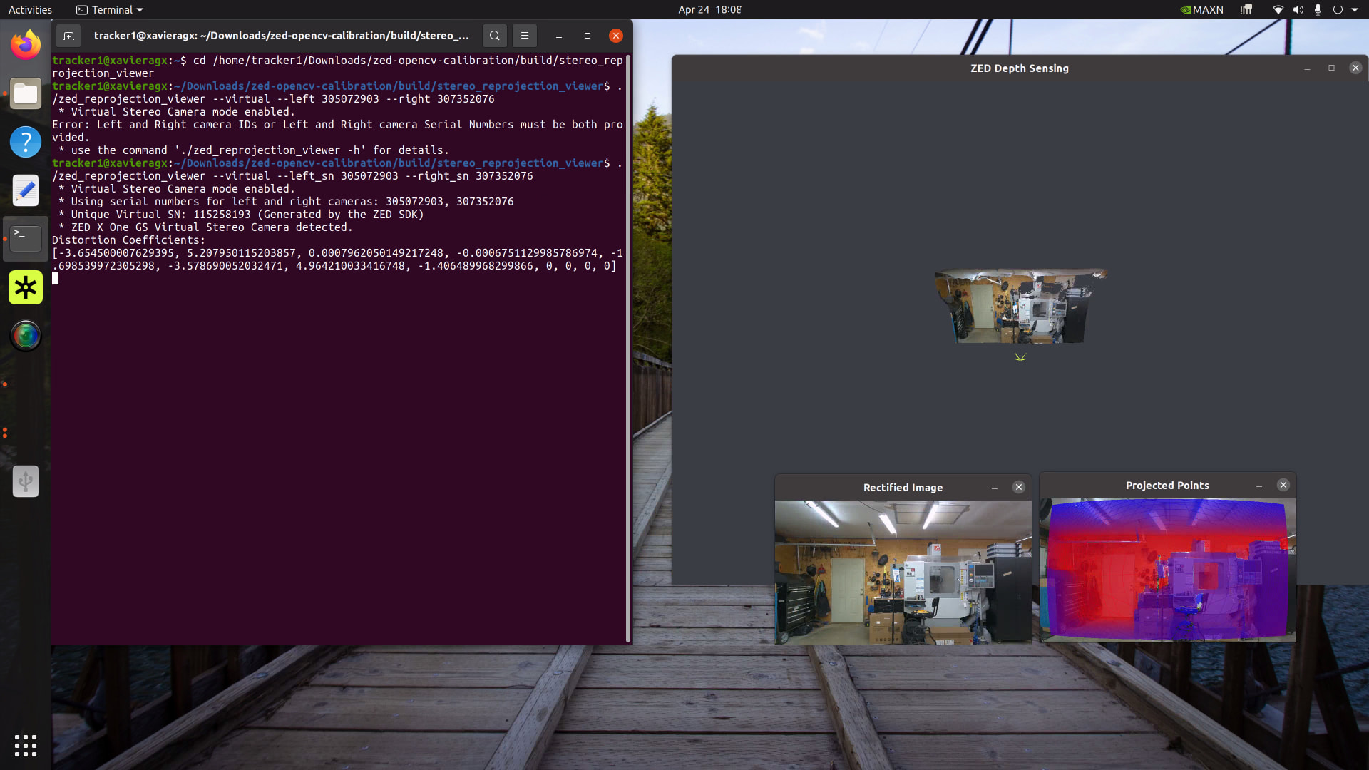

Yes. It said it detected the virtual camera and opened it!
Here is the terminal printout.
tracker1@xavieragx:~/Downloads/zed-opencv-calibration/build/stereo_reprojection_viewer$ ./zed_reprojection_viewer --virtual --left_sn 305072903 --right_sn 307352076
  • Virtual Stereo Camera mode enabled.
  • Using serial numbers for left and right cameras: 305072903, 307352076
  • Unique Virtual SN: 115258193 (Generated by the ZED SDK)
  • ZED X One GS Virtual Stereo Camera detected.
    Distortion Coefficients:
    [-3.654500007629395, 5.207950115203857, 0.0007962050149217248, -0.0006751129985786974, -1.698539972305298, -3.578690052032471, 4.964210033416748, -1.406489968299866, 0, 0, 0, 0]
I also attached a screen shot.
