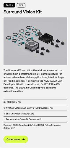

A note to sales: The link to the surround vision kit which interests us most in this context is broken.

What is the origin page of this link?
Its this field at the bottom of the offroad autonomy page! Thanks!
Hi @360vision
Thank you for reporting the problem. The website team is fixing it.
