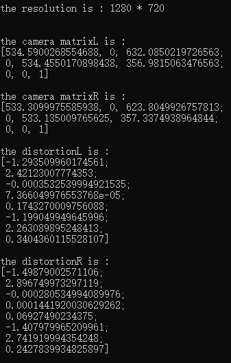

I’m using ZED 2i to do stereo camera calibration and depth measurement . Here is my idea:
I catch the raw image, calibrate the stereo camera myself, compare the calibration result with your calibration file, and use this parameter as the basis for depth measurement, but I have problems in the calibration stage and have not yet moved to the next step.
If set the resolution to HD720, then I should get the corresponding values under [LEFT_CAM_HD] and [RIGHT_CAM_HD] in the SN file, right?
When I get the camera parameters from your SDK, the results do not seem to correspond to the parameters under HD720, why? And how should I do?
Here is my code :

CameraParameters Camera_para_left = zed.getCameraInformation().camera_configuration.calibration_parameters.left_cam;
CameraParameters Camera_para_right = zed.getCameraInformation().camera_configuration.calibration_parameters.right_cam;
//the changing code,and the ohter code is remained
CameraParameters Camera_para_left = zed.getCameraInformation().camera_configuration.calibration_parameters_raw.left_cam;
CameraParameters Camera_para_right = zed.getCameraInformation().camera_configuration.calibration_parameters_raw.right_cam;

the result is:
and the changing code result is:
Some values of the SN file are as follows:
[LEFT_CAM_HD]
fx=534.59
fy=534.455
cx=632.085
cy=356.9815
k1=-0.0680342
k2=0.0484897
p1=-0.000230024
p2=0.000412872
k3=-0.0191863
[RIGHT_CAM_HD]
fx=533.31
fy=533.135
cx=623.805
cy=357.3375
k1=-0.0708259
k2=0.0545271
p1=-0.000345875
p2=-9.04287e-05
k3=-0.0228891
[LEFT_DISTO]
k1=-1.29351
k2=2.42123
k3=0.174327
k4=-1.19905
k5=2.26309
k6=0.340436
p1=-0.000353254
p2=7.36605e-05
[RIGHT_DISTO]
k1=-1.49879
k2=2.89675
k3=0.0692749
k4=-1.40798
k5=2.74192
k6=0.242784
p1=-0.000280535
p2=0.000144192
