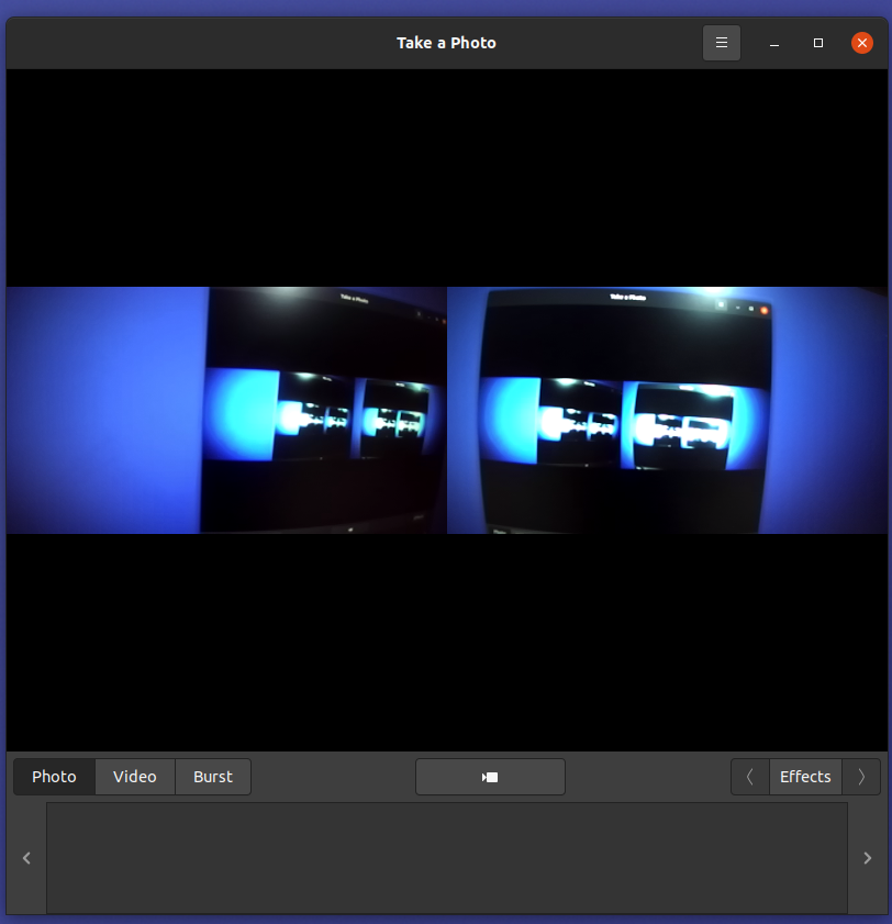

I am using Jetson Xavier AGX with Jetpack version 5.1.2 alongside ZED SDK 5.0, but it is not able to detect the camera, even though it is detected by the OS, and there is a stream that can be read by Cheese.
I would like to add that the Camera works fine in a Windows 11 environment and is detected as a 2.0 USB, which rules out hardware fault possibility

Cheese output
