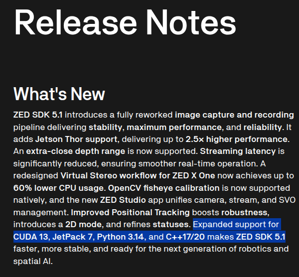

Please change the CMake configuration to use C++17 instead of C++20.
I cannot do that unfortunately, I am using features from c++ 20.
Are you using the latest ZED SDK v5.1.1?
I am using ZED SDK v5.0
Please update to ZED SDK v5.1.
oh cool, thanks! ~~
