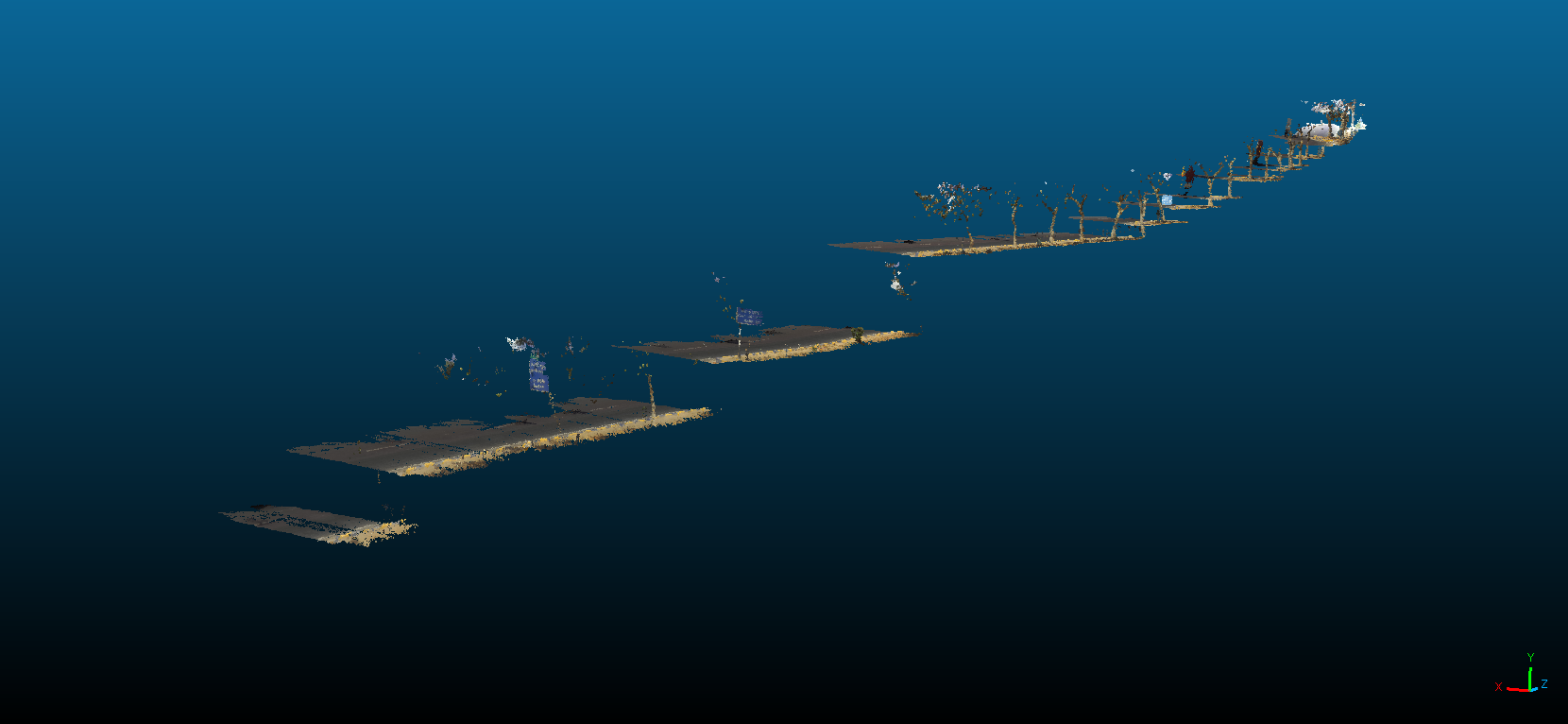

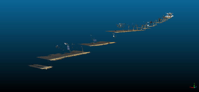

Hi @Myzhar, @TanguyHardelin,
I surveyed an outdoor road using one ZED 2i camera with GPS, mounted on the roof of a car. During the survey, the car was moving at a speed of only 15–20 km/h. I captured an SVO2 file during the run. After the survey, I used ZEDfu to convert the SVO2 file into a point cloud in PLY format. My query is that the resulting point cloud shows a rumble or break in a continuous section, even though the road was flat and on a plane.
Images are attached below.

Hi @nitingarg,
What positional tracking mode did you use? Did you disable the GNSS raw calibration? The results you are observing may be due to the GNSS calibration.
