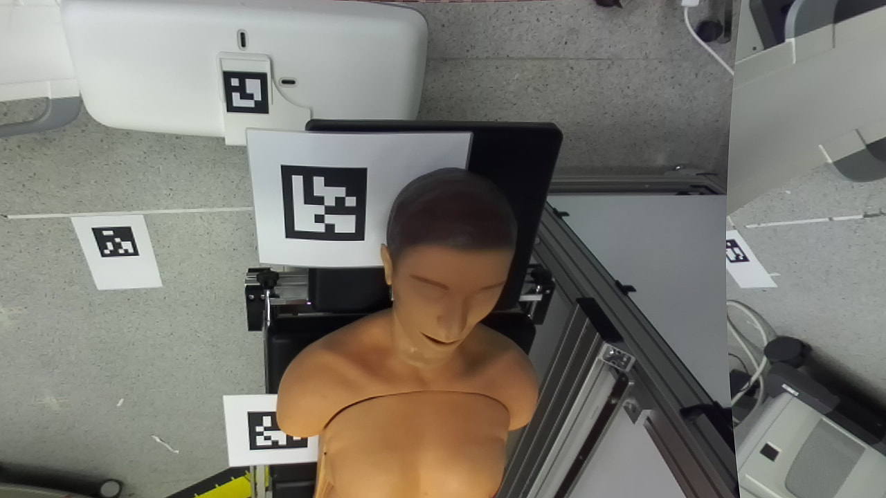

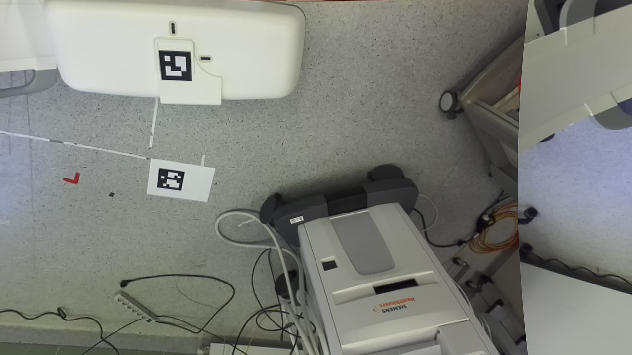

I have encountered this problem when i was using Jetson(ZED mini+ ZED SDK 5.0
) to record videos and svos: from time to time, there will be a broken frame, which messed up the whole slam(the algorithm i developed myself, not sdk module). It looked like two frames were mixed together. And It happened once in two videos(in total i recorded three continuously). And in each video, only one frame was broken and one is at the beginning of the video, one is at the middle of video. I wondered where the problem is from, and i might try to record videos and svos using other computer as comparison. But I would appreciate it if you could have l look and figure out what happened here.
Hi @wft2001,
Could you send the result of the ZED Diagnostic tool JSON file, as well as an SVO that captures this issue? This would help us troubleshoot
Sorry, new users can not upload attachments. Is there any other ways that i can send you.
You can send an email to support@stereolabs.com with a link to this thread, we will be able to track it then.
