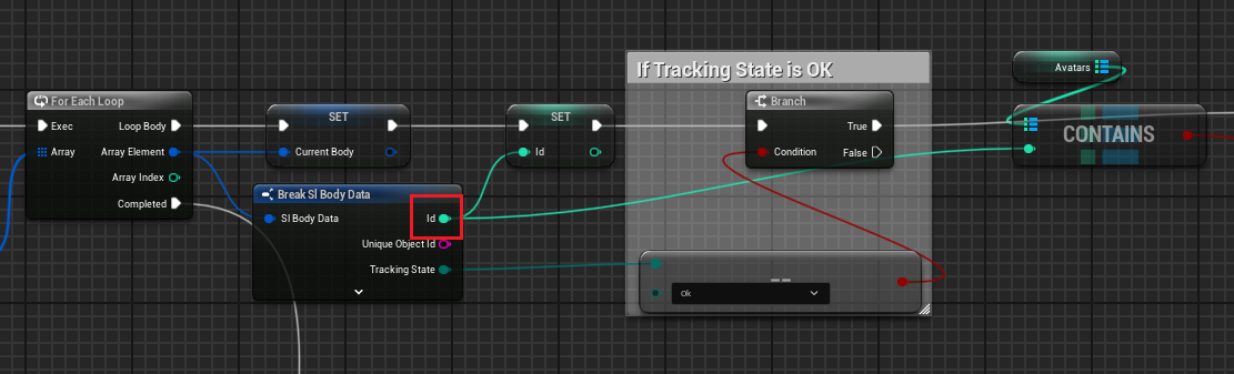

It’s not directly available in the plugin, but there is an easy way of adding it by tracking the detections’ ID. This is something you will have to do on your side.
In the ZED_BodyTracking_Visualizer script, you can get the id here :
We are actually already using this value to know if a mesh needs to be deleted or not (if the person is still detected or not).

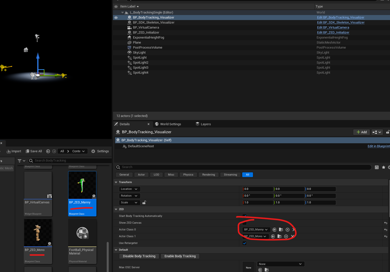

And because UE crashes if I try to use any other BP instead of the BP_ZED_Manny, of course it crashes if I try to d othe following. For example I was thinking of making 2 Actor Class variables (Actor Class 0 and Actor Class 1) and put BP_ZED_Manny in Actor Class 0 and BP_ZED_Mono in Actor Class 1 like you see in the images. But whenever I use something else than BP_ZED_Manny, UE crashes.

If you want to replicate the crash, just duplicate BP_ZED_Manny and you will create a new file named BP_ZED_Manny1. Drag and drop this newly created file in BP_Body_Tracking_Visualizer in ZED → Actor Class. The avatar will appear in T-pose and than UE will crash in less than a second.

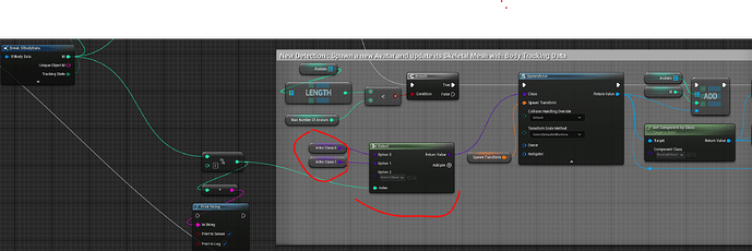

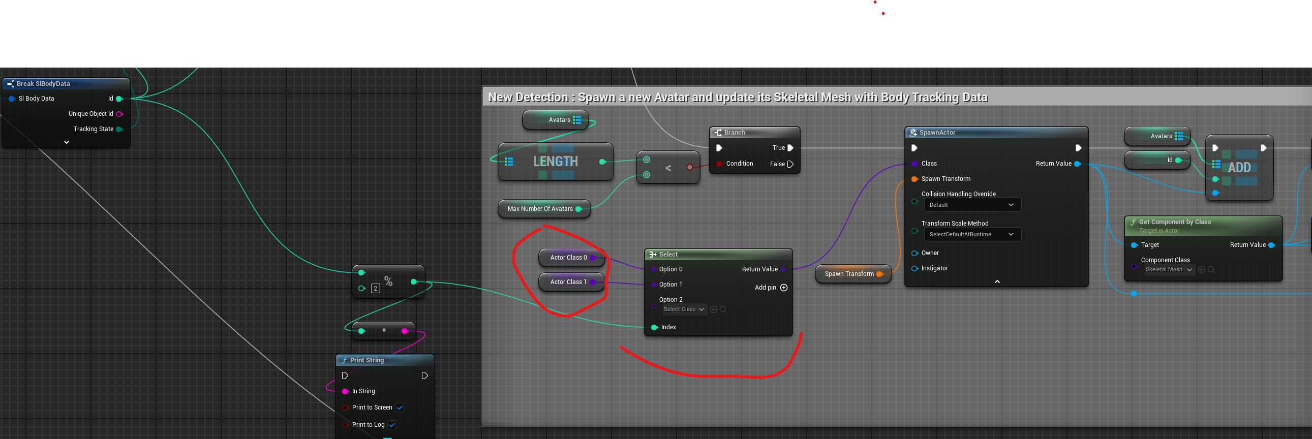

Considering I really don’t know how to use arrays properly, and I only want to have 2 players at the same time (for now), I tried a different approach with the following logic:
  • From id, I get the player id which I go through a modulo to only get a 0 for player 1 and a 1 for player 2
  • I am using 2 sets of ABP_ZED_Manny (ABP_ZED_Manny and ABP_ZED_Manny2), and 2 sets of BP_ZED_Manny (BP_ZED_Manny and BP_ZED_Manny2)
  • Then I duplicate the New Detection : Spawn a new Avatar and update its Skeletal Mesh with Body Tracking Data
  • I use a Switch on int node to activate one spawn or the other
  • I do the same for the part where the Avatar is already in the scene, and only update its Skeletal Mesh. Meaning depending on 0 or 1 coming from id, I activate one or the other branch that technically should control one or the other avatar.
But of course it does not work :slight_smile: But at least UE does not crash.
Please let me know what I am doing wrong.
And this is how BP looks like as of now. You can see the BP here: ZED Body Tracking with UE5: Multiple people with their own mesh tracking them posted by ygreq | blueprintUE | PasteBin For Unreal Engine
Thank you!!!
