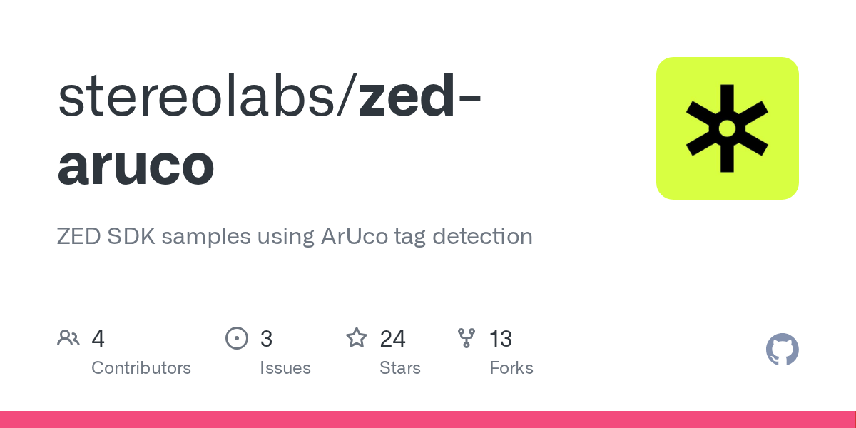

You can use an ArUco tag to retrieve the relative pose of the camera with respect to it:

Thanks Myzhar - and can you just confirm that we need to buy the OpenCV for Unity asset in order to get that working? -
No, you can simply use the example in the repository that I share to obtain the calibration parameters
