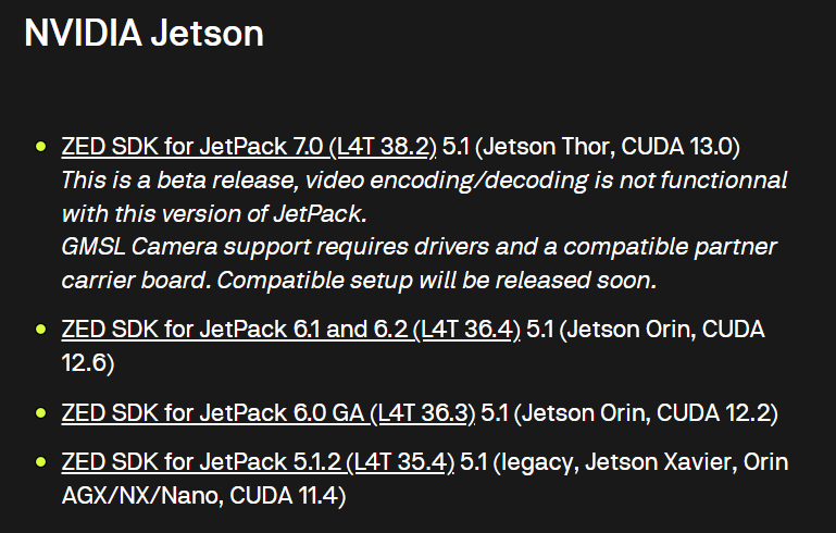

But in your website mentioned that I have to install JetPack 5.1.2 (L4T 35.4) if I have a Jetson AGX.
Can I use the Jetpack 6.1 and 6.2 for both my cameras properly? (ZED X and ZED X mini)
Where have you found this information?
In your website:
What type of Jetson AGX are you speaking about?
AGX is the format type of the Jetson module. There’s not a single AGX model:
  • NVIDIA Jetson Xavier AGX is the first launched.
  • NVIDIA Jetson AGX Orin is the next generation.
  • NVIDIA Jetson AGX Thor is the latest one.
What model are you using?
Only NVIDIA Jetson Xavier AGX does not support Jetpack 6.x.
I have Jetson AGX Orin.
I want to make sure both of my cameras works perfect with Jetpack6.
They do. The ZED SDK always supports all the ZED Stereo cameras that are available in the store.
