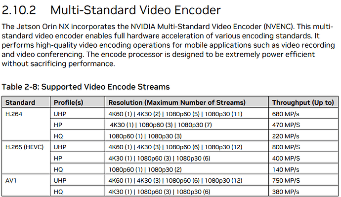

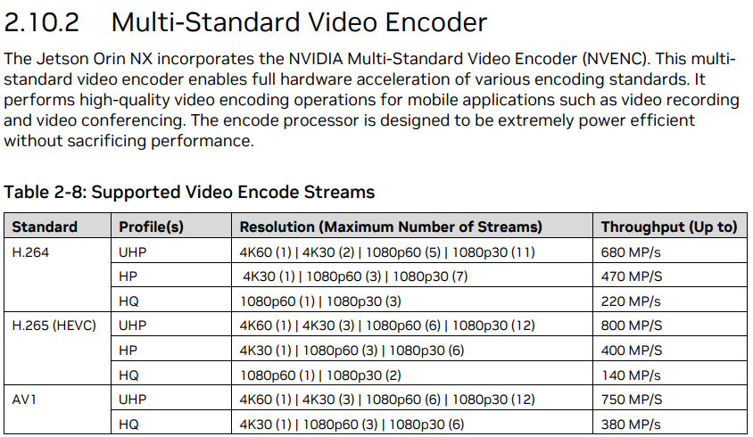

Will there be any support for AV1 encoding when recording svo2 files in the SDK?
Looking at the spec sheet of the NVENC for the Orin NX 16GB, it does support hardware AV1 encoding.
Additional settings for the recording would also be great, even with the current H265 encoding such as region of interest & profile.
If neither is possible, would there be anyway we could handle the encoding ourselves and save it to the svo2 file?

We are investigating the possibility of integrating it with future versions of the ZED SDK.
This is not possible. SVO2 is a closed format.
