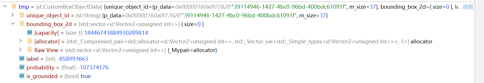

But I found that sl::CustomBoxObjectData seems to have some exceptions:
bounding_box_2d [capacity] has an incorrect value, so that an error occurs when it is released.
I don’t know whether this is caused by the Windows platform, but this problem is inevitable, so it can’t be carried out at all.
int main() {
sl::CustomBoxObjectData tmp;
Just such simple code will also throw an exception at the end of the method.

int main() {
std::cout << "size(): " << tmp.bounding_box_2d.size() << std::endl;
std::cout << "capacity(): " << tmp.bounding_box_2d.capacity() << std::endl;
return 0;
D:\yuanlu\dev\cpp\ifr\zed-test\cmake-build-debug\zed_test.exe
size(): 0
capacity(): 18446743830405820717
exit code: -1073740791 (0xC0000409)
