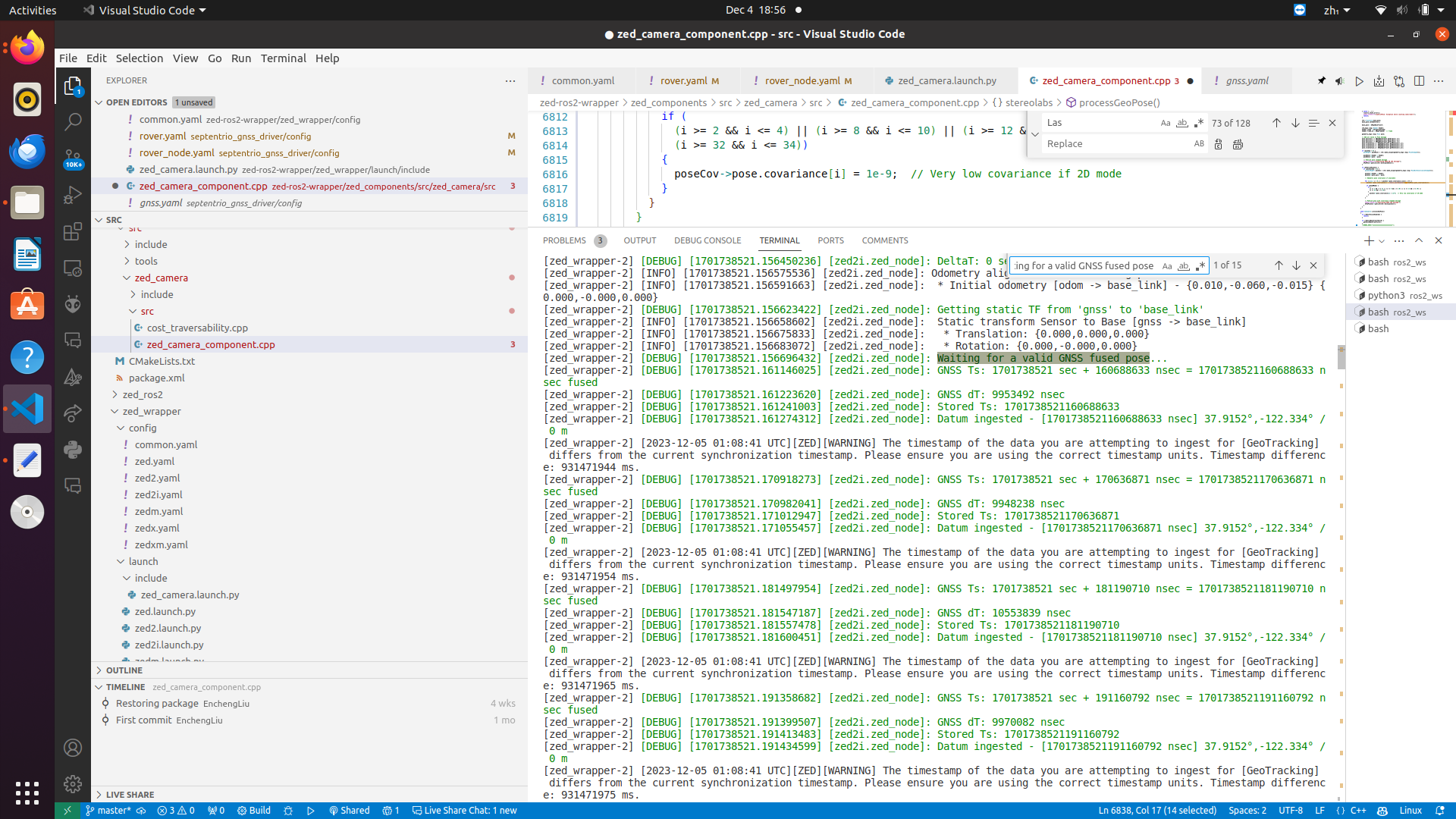

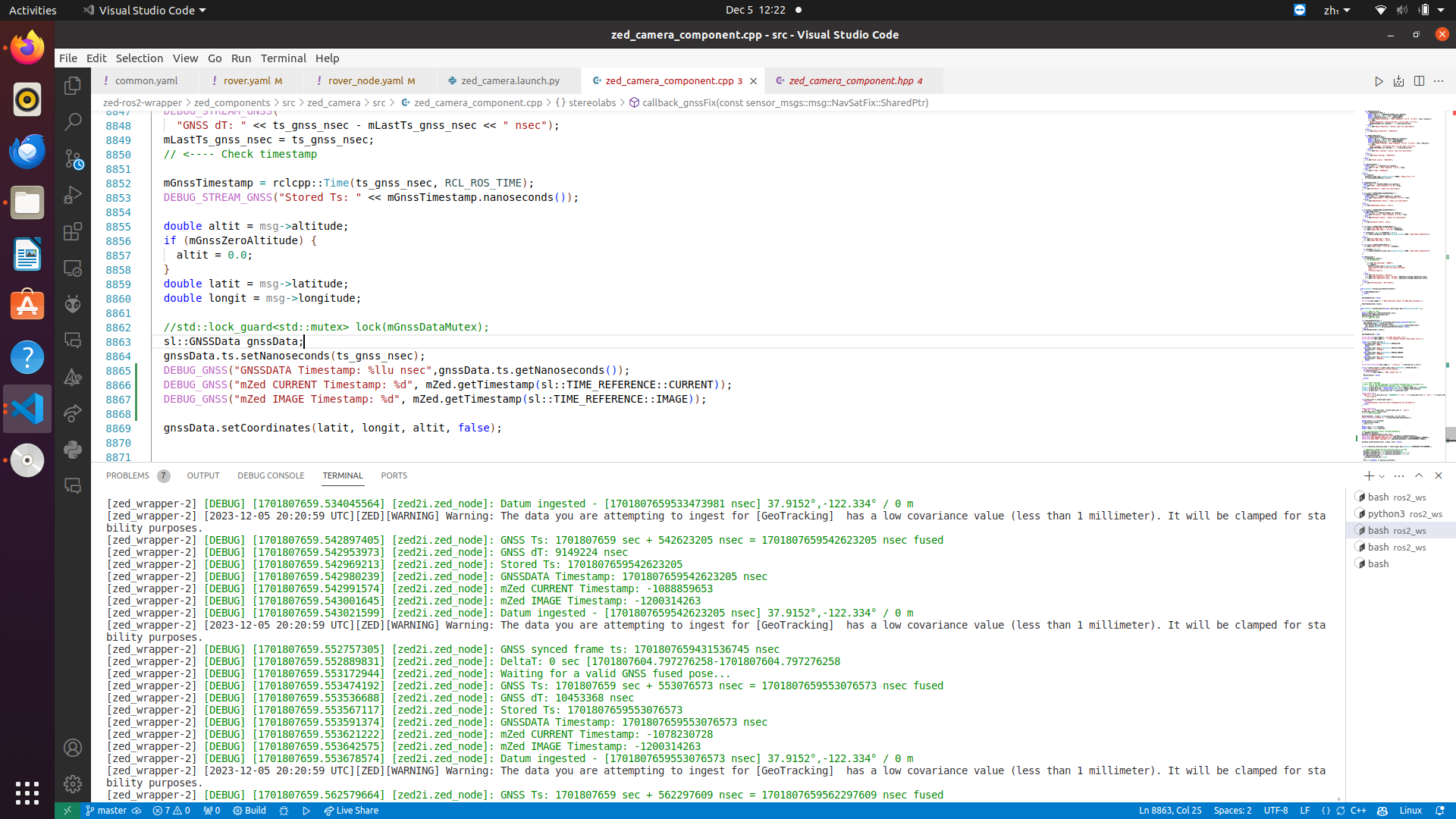

Hi, I add these two timestamp checking at the callback of gpsfix, And in the image is the output, can you check it and tell me how to fix that?
You seem to have an overflow issue in your print. The timestamp must be a positive number (number of nanoseconds since epoch). Basically in C++ it a uint64_t or unsigned long long type. Could you print the timestamp with the following code:

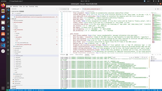

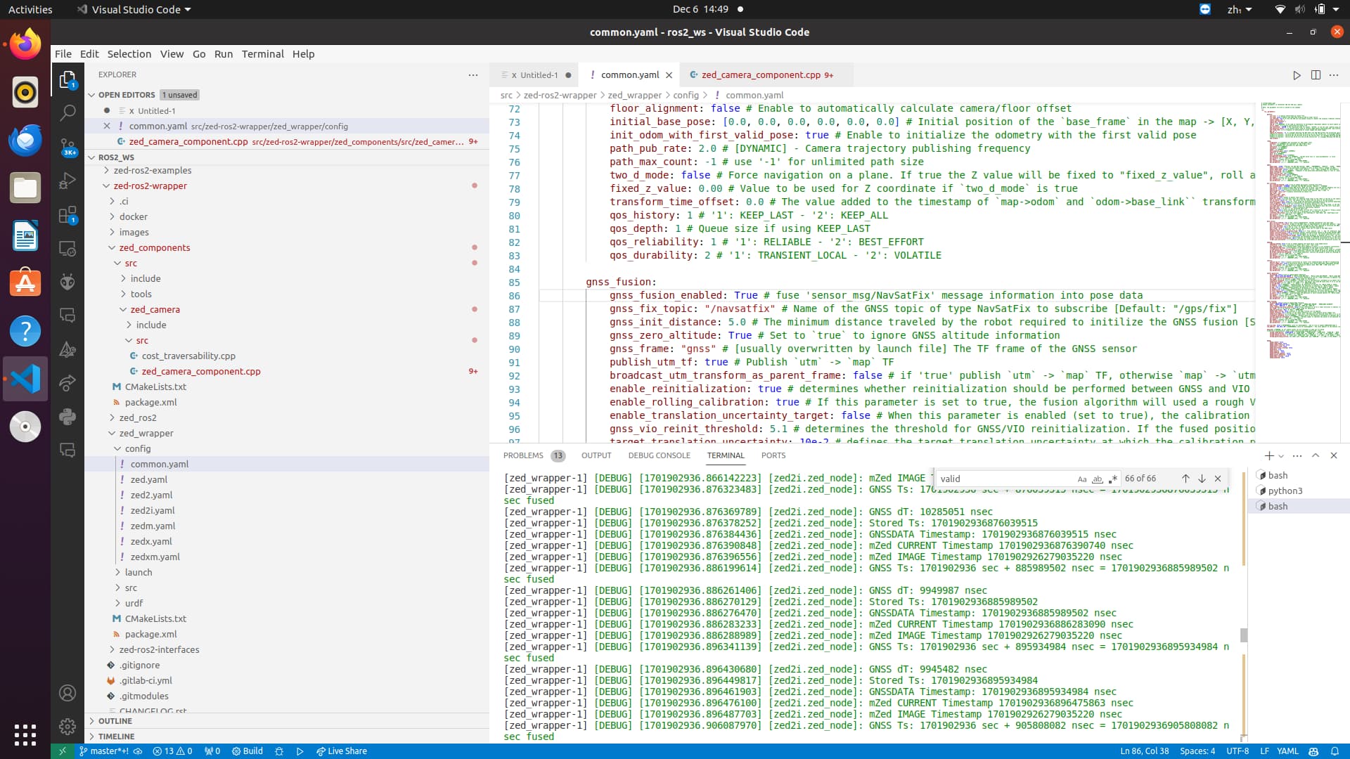

Hi, here is the correct timestamp, can you help me fix it?
Many thanks!
Indeed it seems to be a valid timestamp. In your last logs the warning log changed and now it seems that you are ingesting data with low covariance value (the message Always waiting for a valid GNSS pose in GNSS fusion! - #5 by EnchengLiu) and in your last message it seems that you do not have warning messages anymore.

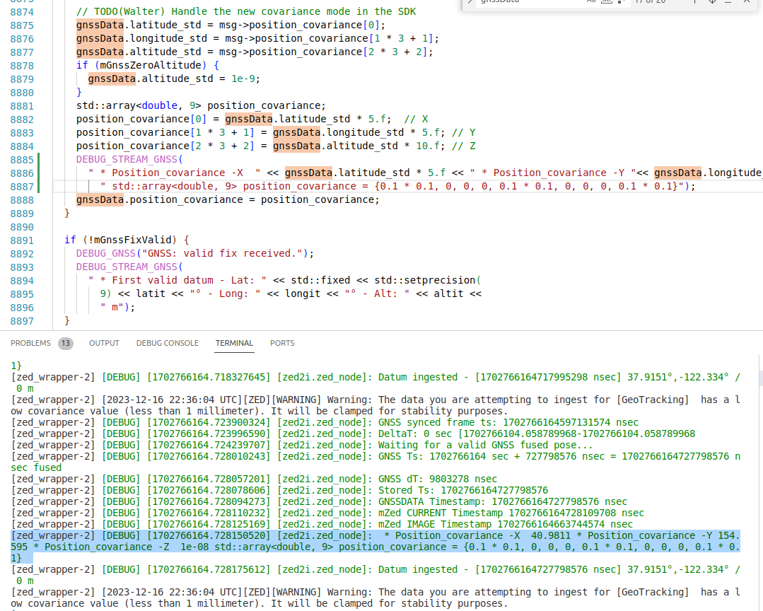

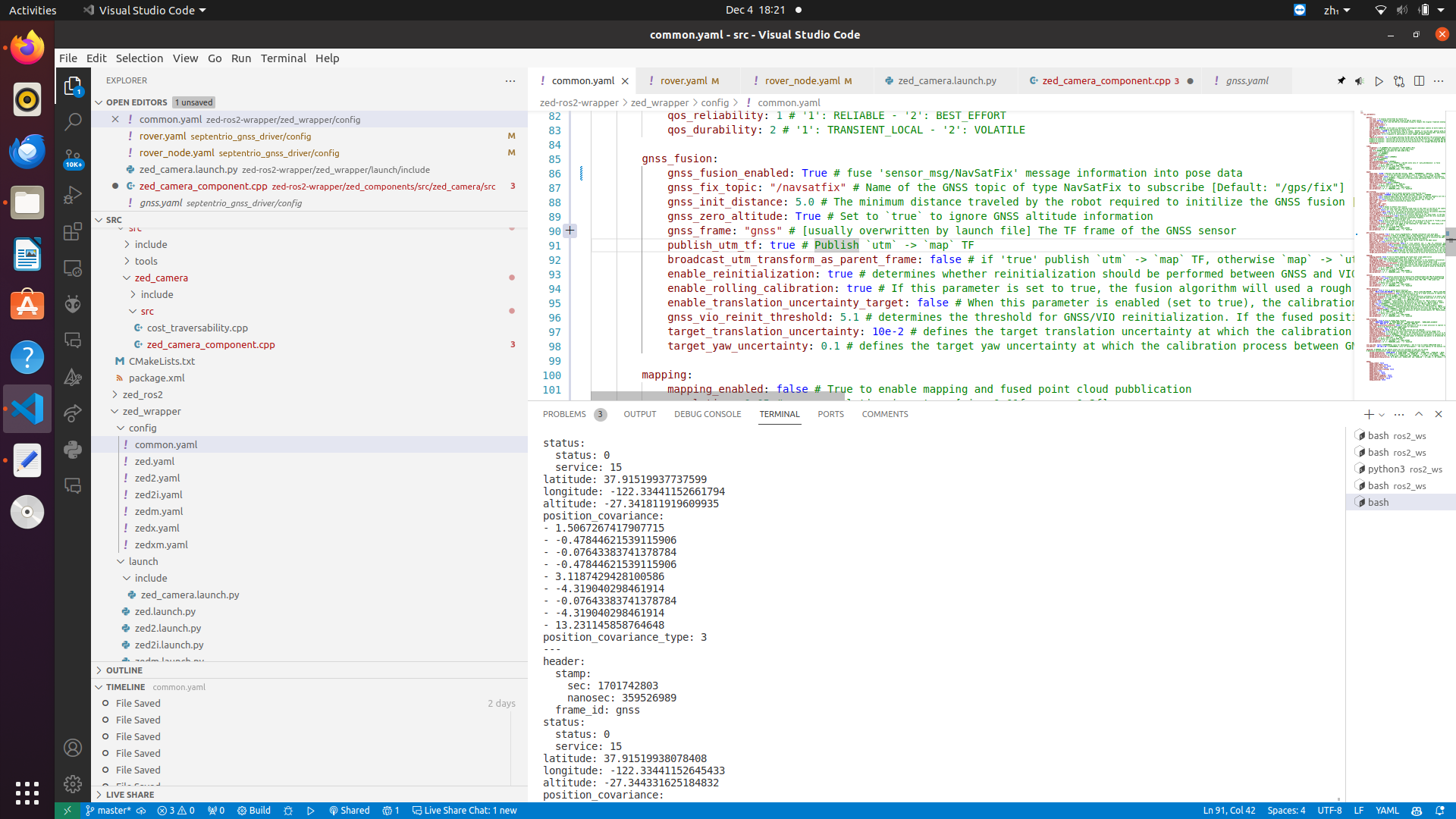

Hi, I printed out my msg->position with convariance here. The msg is from Sensor_msgs/NavSatFix topic in Ros2.
And the message in my terminal said that:
  • msg->position_covariance_type (no output here)
    Position_covariance -X 40.9811
    Position_covariance -Y 154.595
    Position_covariance -Z 1e-08
    And there is also a low covariance error here.
Can you tell me what to do next?
Thank you!
Indeed from your log I saw that you ingest very low covariance on the Z axis (1e-8) could you try something more reasonable values (like one meter for testing) ?
Thank you for your reply!
This time I checked the configuration file common.yaml and Set the Setting gnss_zero_altitude to False, to this time it can output a normal Position Covariance.
So this time, there is no Low Covariance Warning in our code. And the message topic ~/geo_pose/status and ~/pose/filtered/status are true now. Thank you!

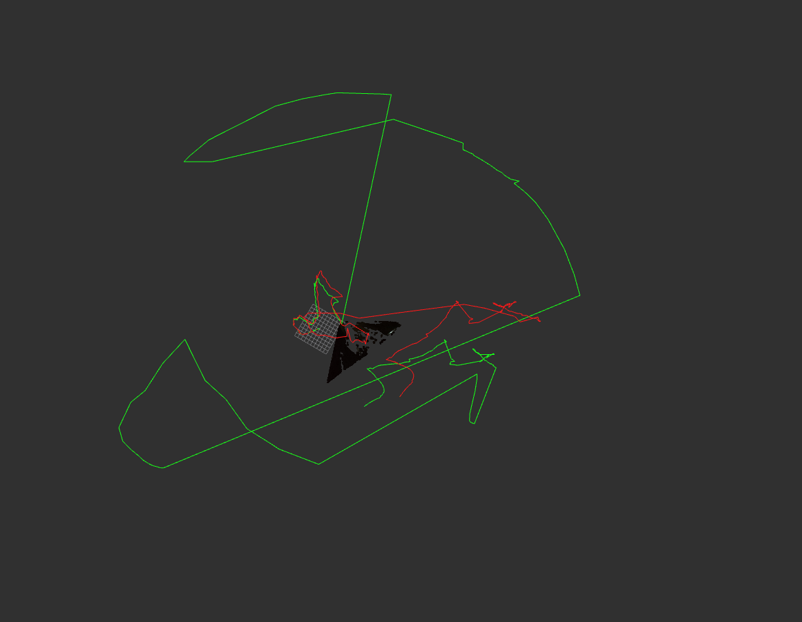

But there is one more problem when I try to plot the path of the fused position, as you mentioned in [~/path_map]in Adding Positional Tracking in ROS 2 - Stereolabs and ~/path_odom. The after-fused path I plotted in RVIZ are scatted and nonuniform, much more worse than the unfused one. The link here is my current log . And current path plot. Can you tell me how to make the after fused path correct? Or can you give me some examples to illustrate it?

Upon reviewing your trajectory, it appears that there are intermittent jumps. This phenomenon could be attributed to two primary factors:
  1. Rolling Calibration:
    It seems you have enabled enable_rolling_calibration, causing the fused position to jump with each new calibration estimation. While this behavior helps in obtaining calibration quickly, it may introduce uncertainty, leading to jumps. You can deactivate this behavior by setting enable_rolling_calibration to false. The relevant configuration can be adjusted here.
  2. Calibration Quality:
    If the calibration is not sufficiently accurate, the system may enter “re-initialization mode.” In your current setup, the target yaw uncertainty is set at 0.1 radians, which might be a bit high. Consider lowering it to 0.01 to improve calibration. During the initialization phase, the fusion module estimates the yaw difference between the VIO path orientation and the GNSS path orientation. This process runs in the background until the solution uncertainty falls below target_yaw_uncertainty. You can make this adjustment here.
Despite these challenges, the end of your trajectory seems satisfactory. Have you experimented with slight movements to check if any new jumps occur?
