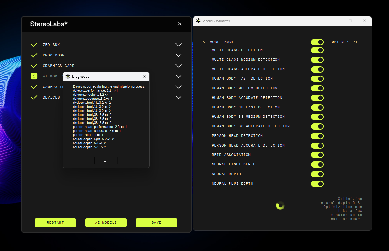

I’m encountering two related issues with the ZED SDK 5.0.7 on Windows 11 (CUDA 12.8, Pascal GPU):
  1. AI Model Optimization Failure
    • Initial diagnostics pass, but the model optimization step fails.
    • Attached: Error logs from the optimization process.
  2. GPU Recognition Issues

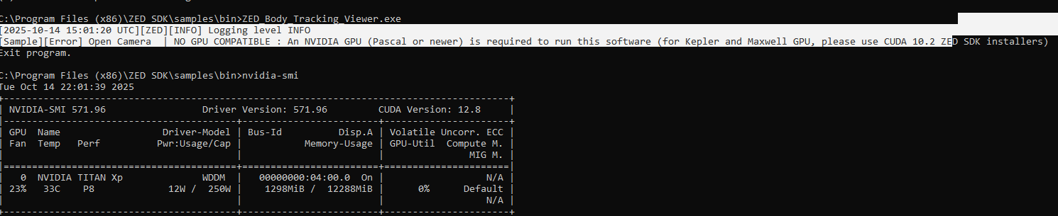

    • Some SDK examples fail to recognize GPU support, despite my GPU (Pascal) being within the supported range.
    • Attached: Error logs from example runs.

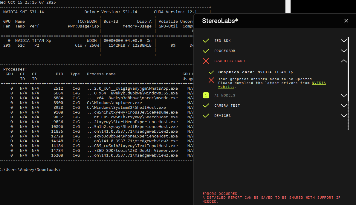

Yes, you are indeed using a GPU with Pascal architecture.
after installing zed sdk5.0.7 win10_11_cuda_12.1_trt8.6 on win 11
consequently, downgrading the cuda to 12.1 to match the sdk
given cuda 12.1 comes with driver version 531 the zed sdk won’t work saying all good but driver needs updated to latest. which is misleading
obviously cuda 12.1 doesn’t support latest driver neither 5.0.7 sdk listed for cuda 12.1 supports the driver that cuda 12.1 supports

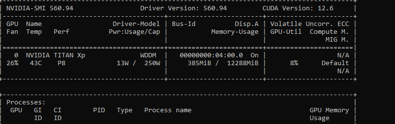

so, after upgrade let say we got cuda 12.6 with driver 560
now again the sdk doesn’t recogfnize the GPU as the cuda version mismatches what declared for the zed -12.1 and what got with updating the cuda 12.1 driver to get a newer driver
let me know which exactly version of cuda to install which version of the driver that should work with PAscal please

with that one zedfu says no GPU thus perhaps because now cuda version shifted due to driver upgrade
there is no model optimization error - it got addressed.
but zedfu or depth viewer won’t run perhaps because they cannot get that combination of cuda +driver supported with that version of zed sdk

I’m experiencing a similar issue when trying to optimize the AI model using ZED Diagnostic.
My setup is a bit different, but the same error occurs during the optimization process:
  • GPU: RTX 5060 Ti (Driver v581.57)
  • VRAM: 16GB
  • CUDA: 12.8
  • ZED SDK: 5.0.7 (CUDA 12.8 & TensorRT 10.9)
  • Windows 11
The optimization fails every time, and I’ve already tried reinstalling the SDK and using different CUDA versions, but no luck.

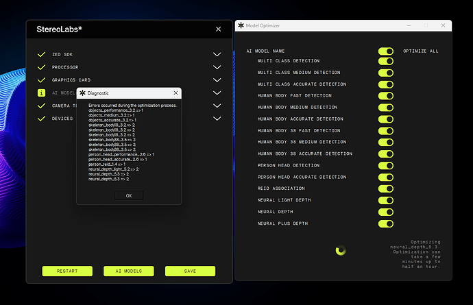

I started the optimization, and after it finished, I optimized all AI MODELS from the “AI MODELS” section. I then extracted the logs afterward.
ZED_Diagnostic_Results.json (14.0 KB)
Does it work now?
If not, please send me the diagnostic report after the optimizations that you performed, the log that you’ve sent has been created before the optimizations.
There is no button in the AI MODEL optimization window to extract a diagnostic report.
How are we supposed to generate a diagnostic report after optimizing all the AI MODELs?
