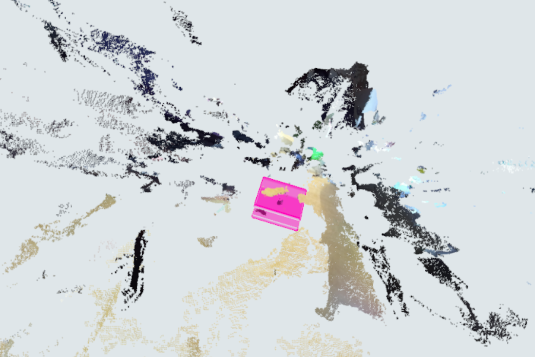

When I obtained the dimensions of the object to be detected, I found that the width and length of the data were the same regardless of the viewing angle, which is obviously very different from the truth, do you know what the reason is?
@NineSeven Can you explain what you mean?
Pictures showing the problem can help understand it better
The width and height of the object I actually measured were 5.9, 5.5, and 14.6 (cm) respectively, and now the output is as follows(id is 10):
Do you have pictures of the objects showing bounding boxes and measures to understand what’s happening?
Numbers without a visual context are not enough to analyze the problem.
It seems that you are too close to the object and you are using a depth mode that does not provide good point cloud information.
What settings are you using?
Please also note that the bounding box of the object is not oriented according to the object, but it’s always perpendicular to the image sides, so different orientations of tall objects can lead to different measurements.
