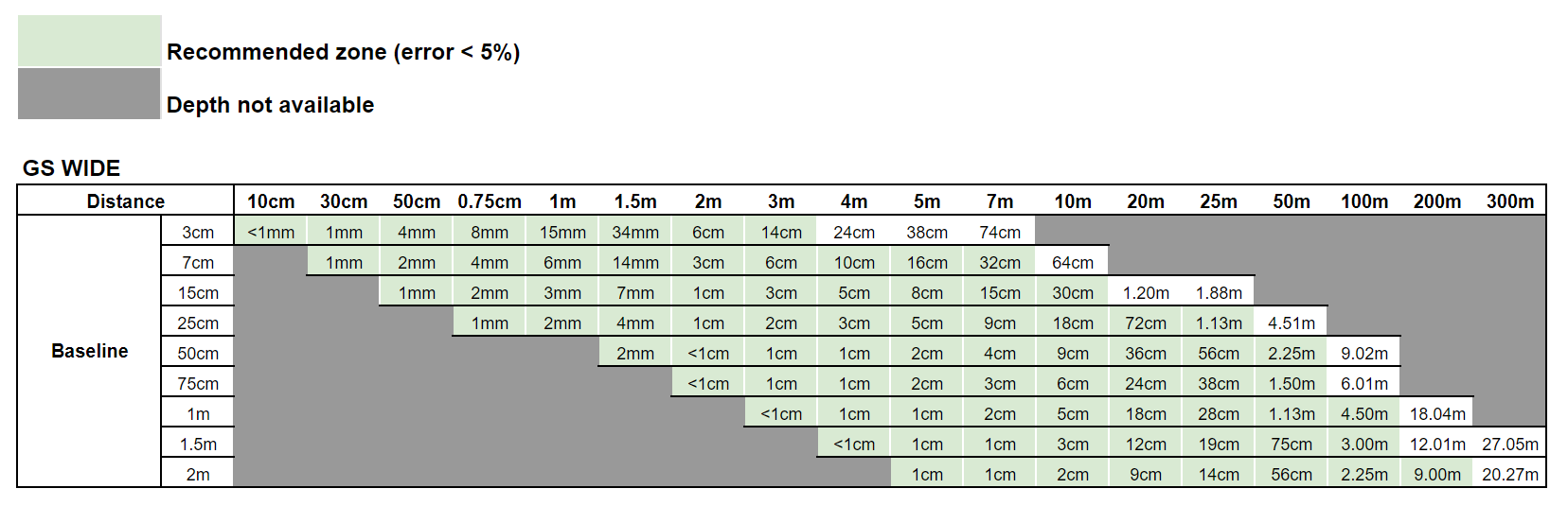

The view is changed to a screen with the camera feed in the upper left, depth at bottom and point cloud visualization on the right. The depth and point cloud screens are nearly empty until “Confidence 95” is unselected. The scene is an office wall with a person sitting at the computer in the foreground, about 2m away (the baseline of the stereo pair according to stereo calibration is Baseline = 222.755 which should have 1cm error at 2m according to this chart.
