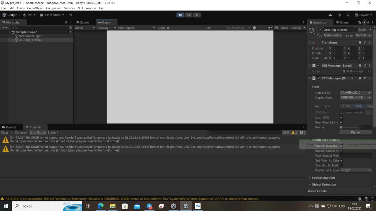

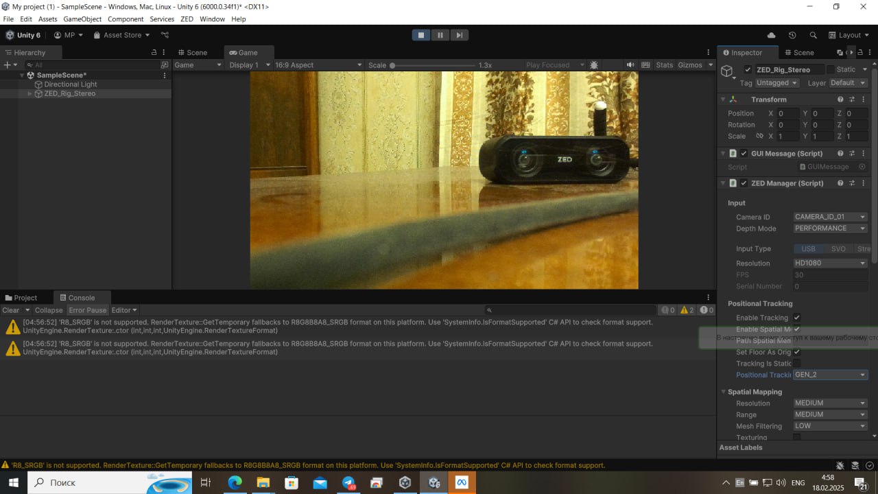

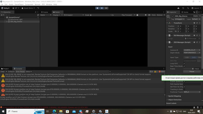

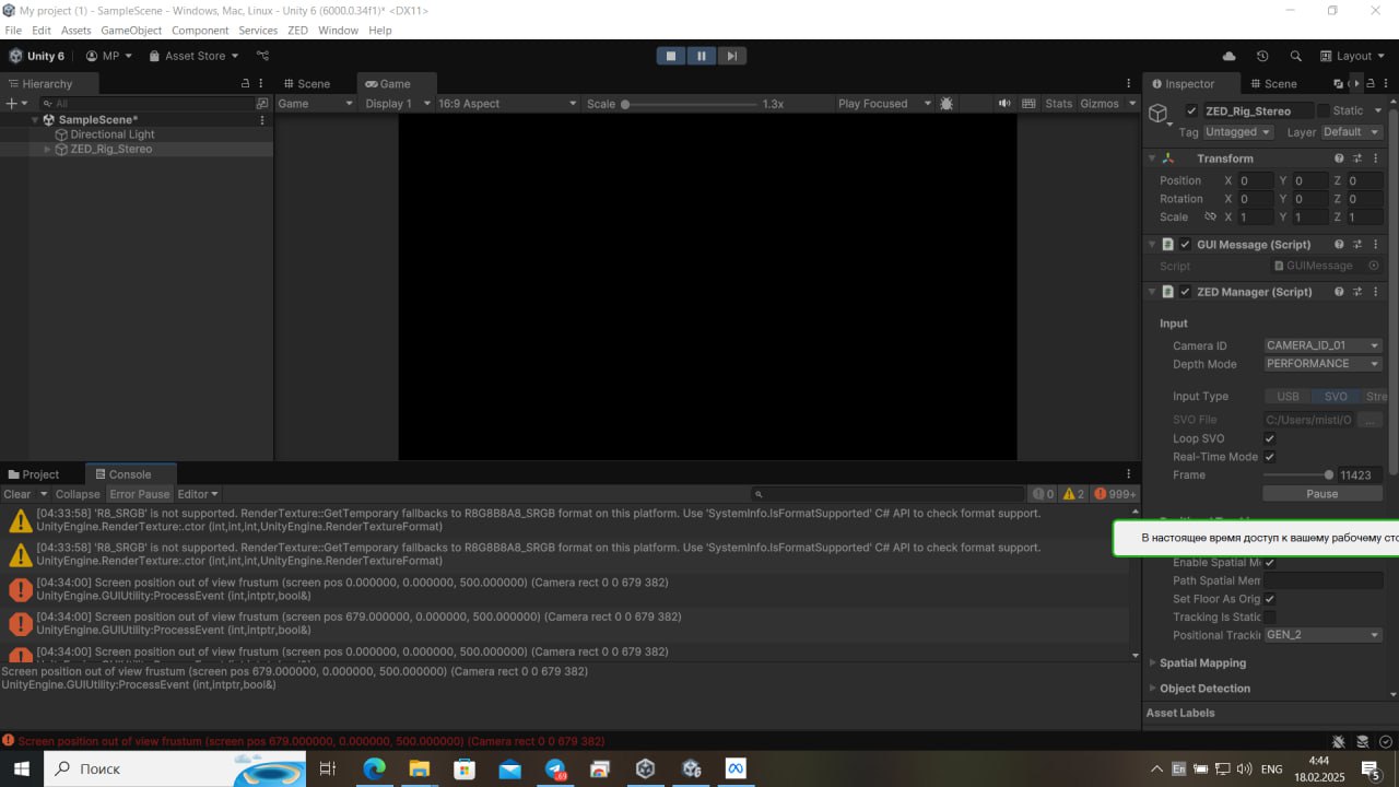

I use unity 6. I tested the plugin yesterday with all types of incoming data. Streaming over a local wired network does not load at all and no errors pop up in the console. Videos from the file and the old zed via usb are opened in mono mode. Accordingly, the helmet does not see them. I tried to set up the project for Open XR. The error related to connecting the helmet has disappeared, but the link still won’t start…
In your screenshots, you never have the input set a stream, it’s either SVO or USB, is that normal?
Stereolabs Support
There are no messages in the console where I installed the incoming stream, so I didn’t make a screenshot. It just doesn’t load the video stream into the scene.
