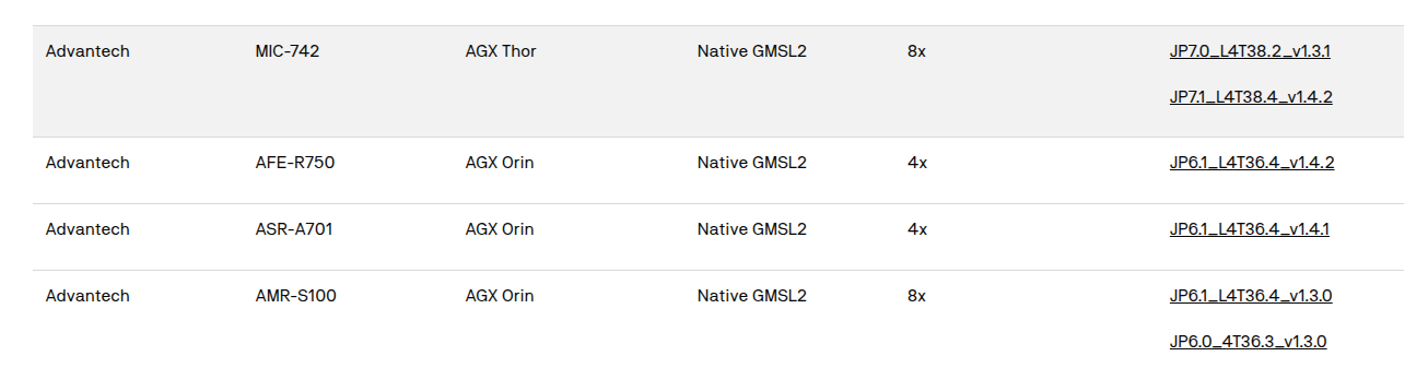

Hi @sanjeev-kumar
This model is not yet supported by the ZED X Driver. We currently support only the Advantech MIC-742 Thor-powered model:
I recommend you contact Advantech for details and information concerning new supported platforms.
